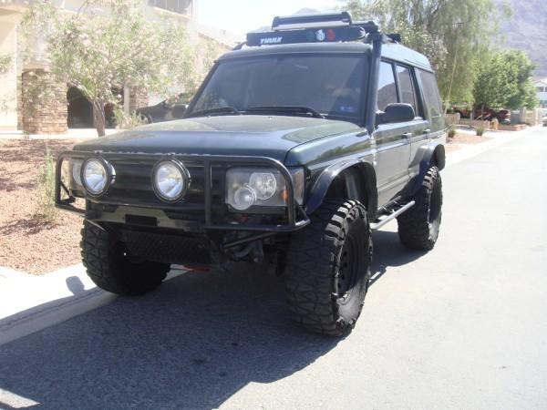

Btw, here's a pic of my rover!
Great looking machine!
